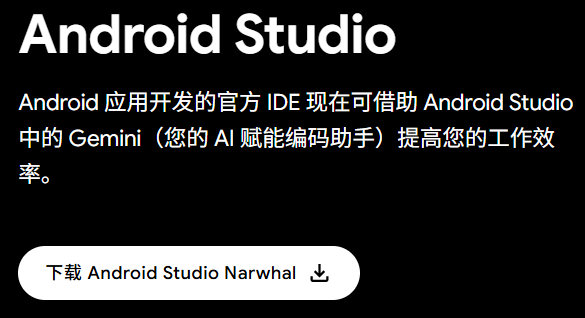

安装软件
Android Studio

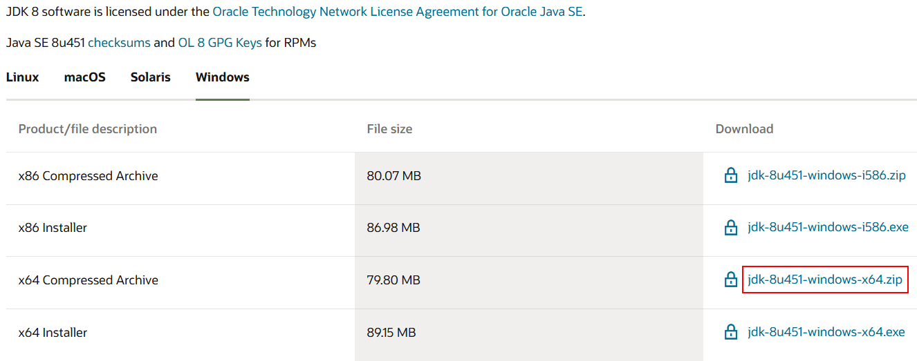

java8下载后解压

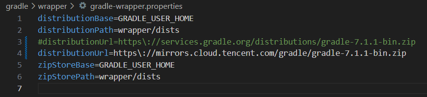

gradle/wrapper/gradle-wrapper.properties
distributionUrl=https\://mirrors.cloud.tencent.com/gradle/gradle-7.1.1-bin.zip

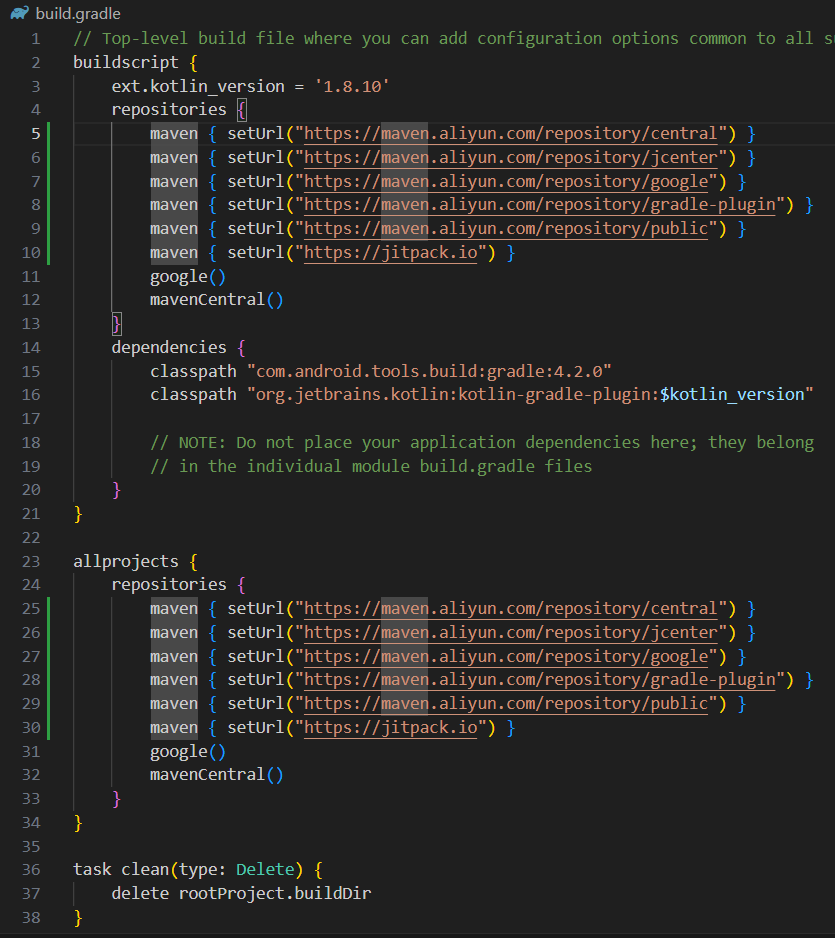

build.gradle
        maven { setUrl("https://maven.aliyun.com/repository/central") }
        maven { setUrl("https://maven.aliyun.com/repository/jcenter") }
        maven { setUrl("https://maven.aliyun.com/repository/google") }
        maven { setUrl("https://maven.aliyun.com/repository/gradle-plugin") }
        maven { setUrl("https://maven.aliyun.com/repository/public") }
        maven { setUrl("https://jitpack.io") }

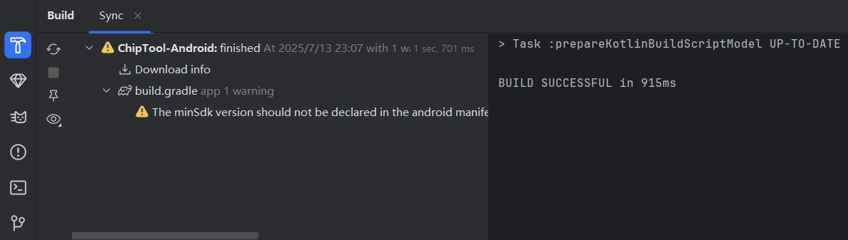

编译
Android Studio打开目录 ChipTool-Android

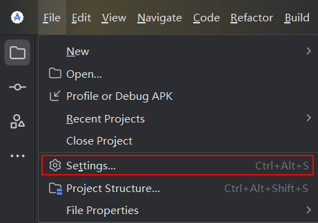

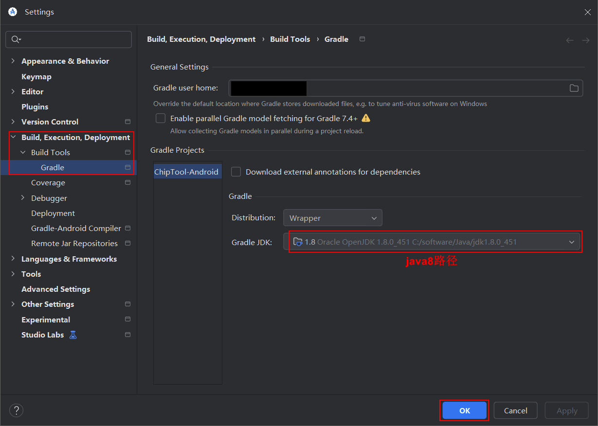

设置Java8
编译
模拟运行,生成apk
apk文件保存在app/build/outputs/apk/debug/app-debug.apk
