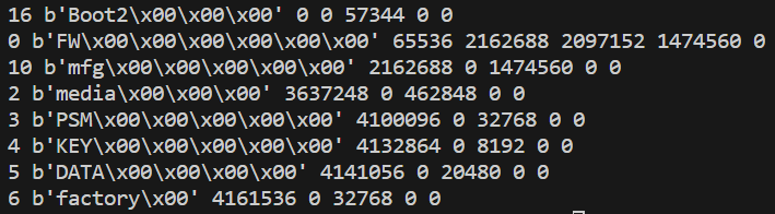

emmmm我参考https://github.com/spacemeowx2/blflashhttps://github.com/bouffalolab/BLOpenFlasher用python搓了一个生成partition的玩具
  1. import argparse
  2. import toml
  3. import struct
  4. import zlib
  5. def create_partition_bin(if_name, of_name):
  6.     with open(if_name, 'r') as file:
  7.         data = toml.load(file)
  8.     entry_list = data.get('pt_entry', [])
  9.     header = b'\x42\x46\x50\x54\x00\x00' + struct.pack('<H', len(entry_list))
  10.     entries = []
  11.     for entry in entry_list:
  12.         entry_type = entry.get('type', 0)
  13.         name = entry.get('name', '')[:8].encode('utf-8').ljust(8, b'\0')
  14.         address0 = entry.get('address0', 0)
  15.         address1 = entry.get('address1', 0)
  16.         size0 = entry.get('size0', 0)
  17.         size1 = entry.get('size1', 0)
  18.         length = entry.get('len', 0)
  19.         print(entry_type, name, address0, address1, size0, size1, length)
  20.         entries.append(struct.pack('<I8sIIIIB', entry_type, name, address0, address1, size0, size1, length))
  21.     checksum = zlib.crc32(header + b''.join(entries)).to_bytes(4, 'little')
  22.     output_bytes = header + b''.join(entries) + checksum
  23.     with open(of_name, 'wb') as file:
  24.         file.write(output_bytes)
  25. if __name__ == "__main__":
  26.     parser = argparse.ArgumentParser(description='Generate partition binary from TOML file.')
  27.     parser.add_argument('input', help='Input TOML file path')
  28.     parser.add_argument('output', help='Output binary file path')
  29.     args = parser.parse_args()
  30.     create_partition_bin(args.input, args.output)
复制代码
但是用生成的partition.bin和aithinker_Ai-M6X_SDK/bsp/board/bl616dk/config/boot2_bl616_release_v8.0.7.bin at master · Ai-Thinker-Open/aithinker_Ai-M6X_SDK (github.com)来刷入固件的时候报错
  1. [10:30:56.627] - Error: path: ##########\Rust\ai_m61_32s_blinky\boot2_bl616_release_v8.0.7.bin  size: 43328  range: 256
  2. [10:30:56.627] - Error: The file size exceeds the address space size!
复制代码
看了下生成的时候boot2划定的大小(size0)为57344,但貌似在BLFlashCube里面识别成了256
emmmm是BLFlashCube所使用的partition二进制文件布局更新了吗
