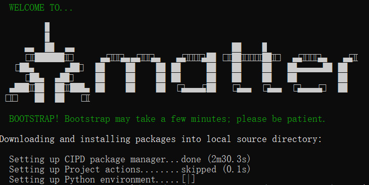

安装Matter编译环境,这个步骤会下载CIPD安装包,可能需要科学上网。试了好几次才成功。可在 .environment/cipd/packages.log中查看下载进度

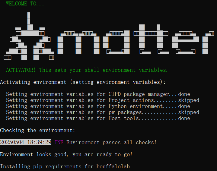

source scripts/activate.sh -p bouffalolab

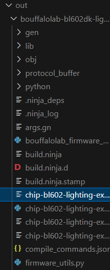

./scripts/build/build_examples.py --target bouffalolab-bl602dk-light-wifi-littlefs build
编译输出目录 out/bouffalolab-bl602dk-light-wifi-littlefs
