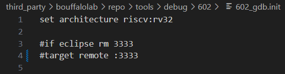

vs code打开WSL2中的目录connectedhomeip
third_party/bouffalolab/repo/tools/debug/602/602_gdb.init中注释掉target remote :3333

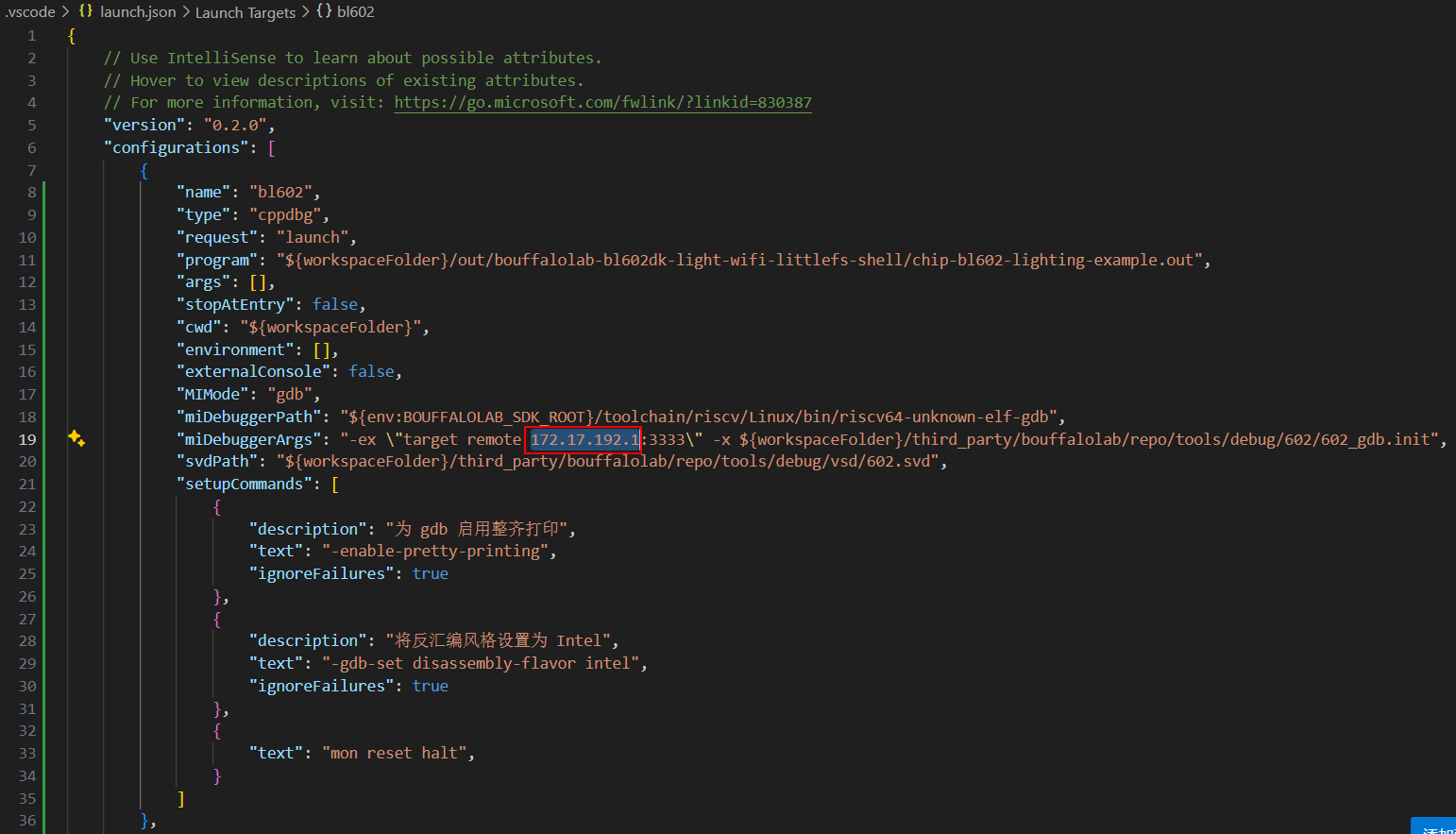

查看gdb server地址 cat /etc/resolv.conf
调试设置
            "name": "bl602",
            "type": "cppdbg",
            "request": "launch",
            "program": "${workspaceFolder}/out/bouffalolab-bl602dk-light-wifi-littlefs-shell/chip-bl602-lighting-example.out",
            "args": [],
            "stopAtEntry": false,
            "cwd": "${workspaceFolder}",
            "environment": [],
            "externalConsole": false,
            "MIMode": "gdb",
            "miDebuggerPath": "${env:BOUFFALOLAB_SDK_ROOT}/toolchain/riscv/Linux/bin/riscv64-unknown-elf-gdb",
            "miDebuggerArgs": "-ex \"target remote 172.17.192.1:3333\" -x ${workspaceFolder}/third_party/bouffalolab/repo/tools/debug/602/602_gdb.init",
            "svdPath": "${workspaceFolder}/third_party/bouffalolab/repo/tools/debug/vsd/602.svd",
            "setupCommands": [
                    "description": "为 gdb 启用整齐打印",
                    "text": "-enable-pretty-printing",
                    "ignoreFailures": true
                    "description": "将反汇编风格设置为 Intel",
                    "text": "-gdb-set disassembly-flavor intel",
                    "text": "mon reset halt",
gdb server地址按实际情况修改
