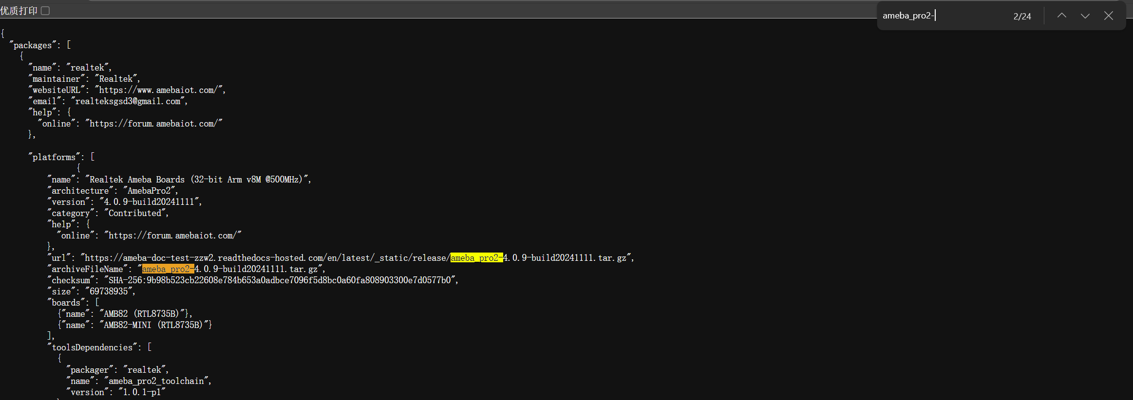

https://ameba-doc-test-zzw2.readthedocs-hosted.com/en/latest/_static/package_realtek_amebapro2_early_index_rtd.json
到浏览器

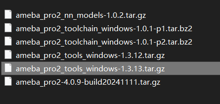

搜索“ameba_pro2-4.”
将配备的URL复制到迅雷,将其下载下来
ameba_pro2-4.0.9-build20241111.tar.gz
https://ameba-doc-test-zzw2.readthedocs-hosted.com/en/latest/_static/release/ameba_pro2-4.0.9-build20241111.tar.gz
ameba_pro2_nn_models-1.0.2.tar.gz
https://ameba-doc-test-zzw2.readthedocs-hosted.com/en/latest/_static/release/ameba_pro2_nn_models-1.0.2.tar.gz
ameba_pro2_toolchain_windows-1.0.1-p1.tar.bz2
https://ameba-doc-test-zzw2.readthedocs-hosted.com/en/latest/_static/release/ameba_pro2_toolchain_windows-1.0.1-p1.tar.bz2
ameba_pro2_toolchain_windows-1.0.1-p2.tar.bz2
https://ameba-doc-test-zzw2.readthedocs-hosted.com/en/latest/_static/release/ameba_pro2_toolchain_windows-1.0.1-p2.tar.bz2
ameba_pro2_tools_windows-1.3.12.tar.gz
https://ameba-doc-test-zzw2.readthedocs-hosted.com/en/latest/_static/release/ameba_pro2_tools_windows-1.3.12.tar.gz
分别将器下载
复制到C盘用户目录\AppData\Local\Arduino15\staging\packages

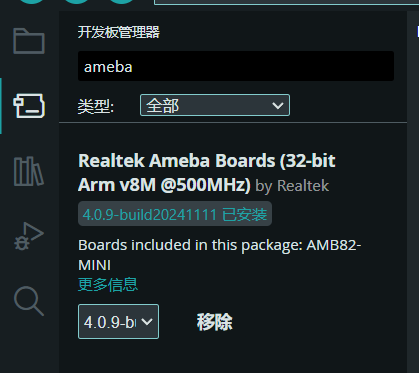

打开arduinoIDE软件
在开发板管理栏搜索ameba
点击安装
等待安装完成

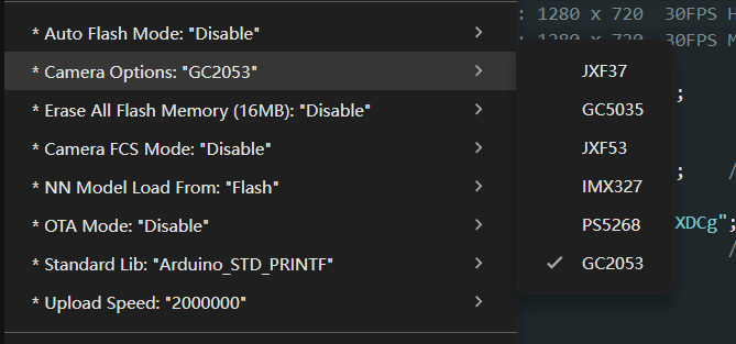

配置摄像头

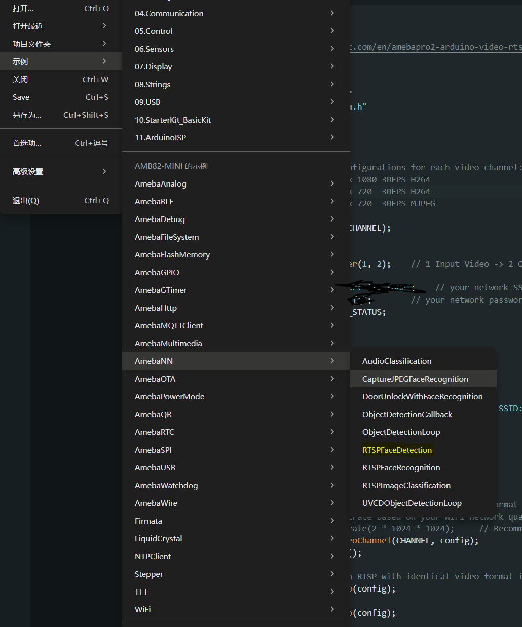

选择实例
设置WIFI账号
编译烧入到开发板

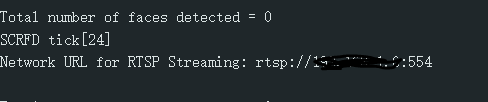

打开串口助手
查看日志信息

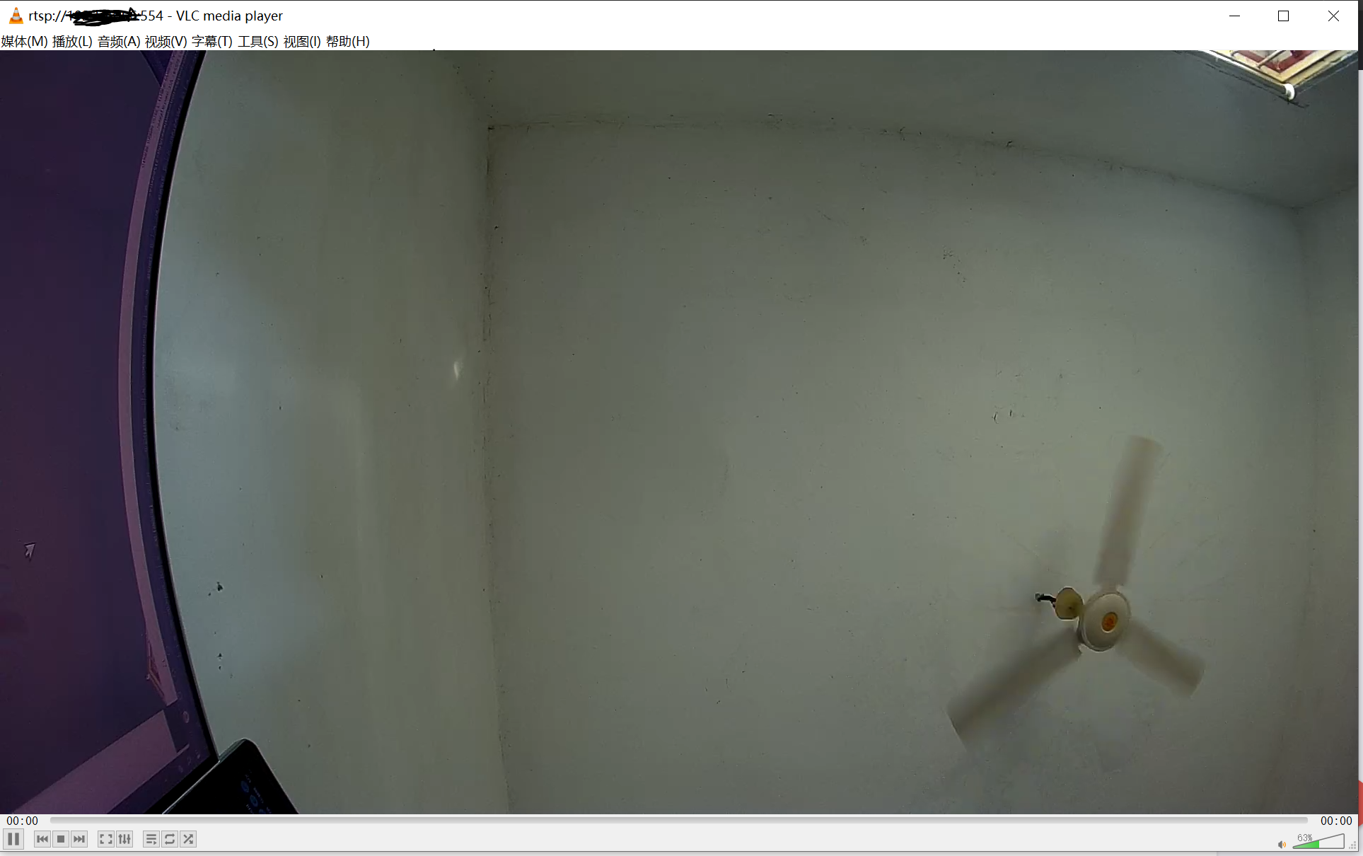

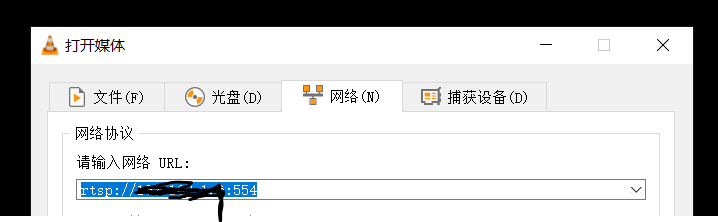

使用VLC media player或PotPlayer 64 bit查看rtsp流媒体
显示效果

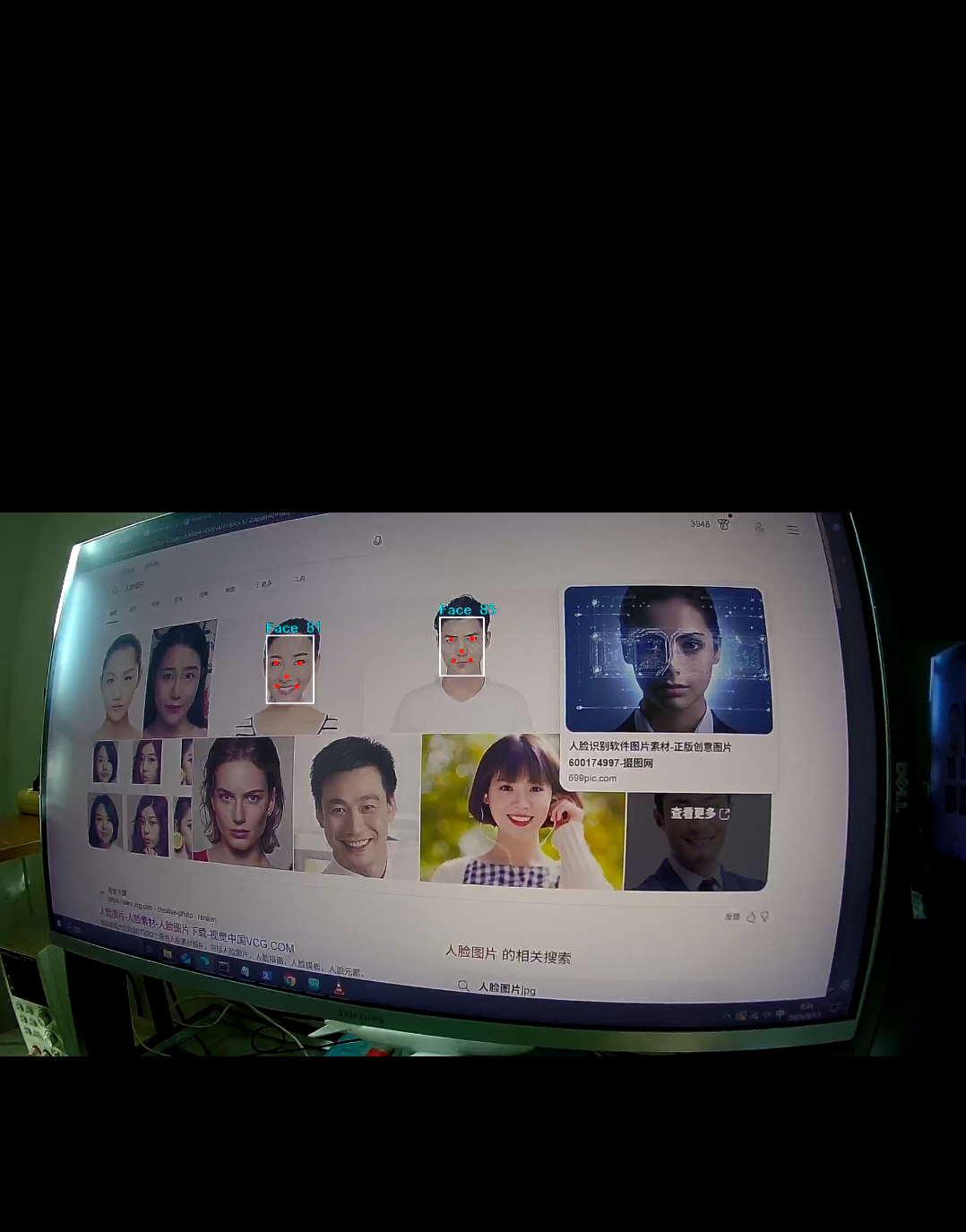

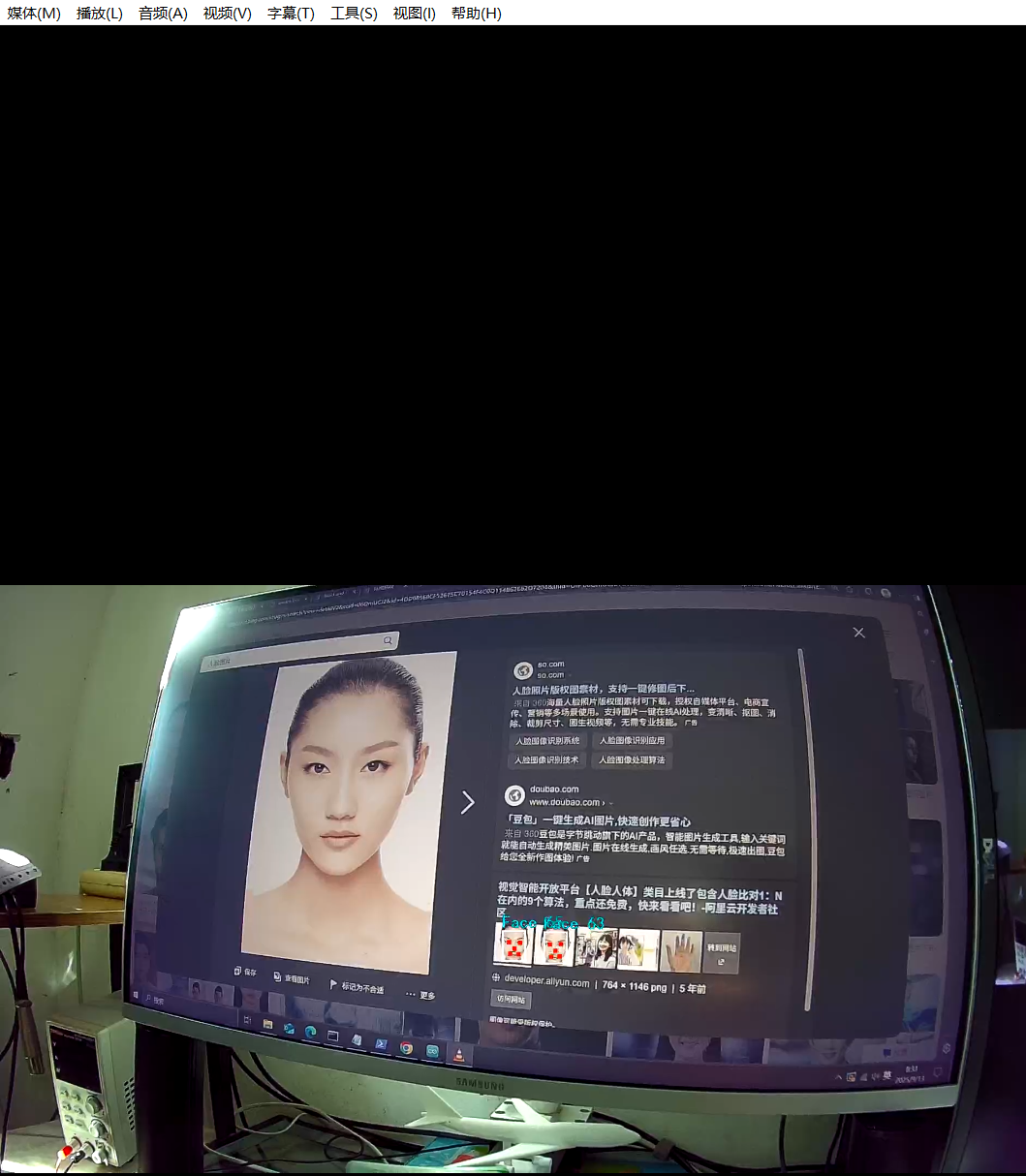

人脸检测效果
效果一
效果二
